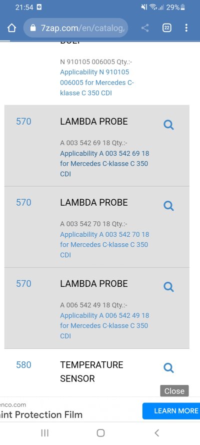

I found one on europarts but don't know if it is correct as another site gives totally different info.
What's the 7zap - googling just gives loads of different pages that either don't work, want to load an app game or just full of advertising banners and nothing else ?
Do you have a working link - could be interesting....

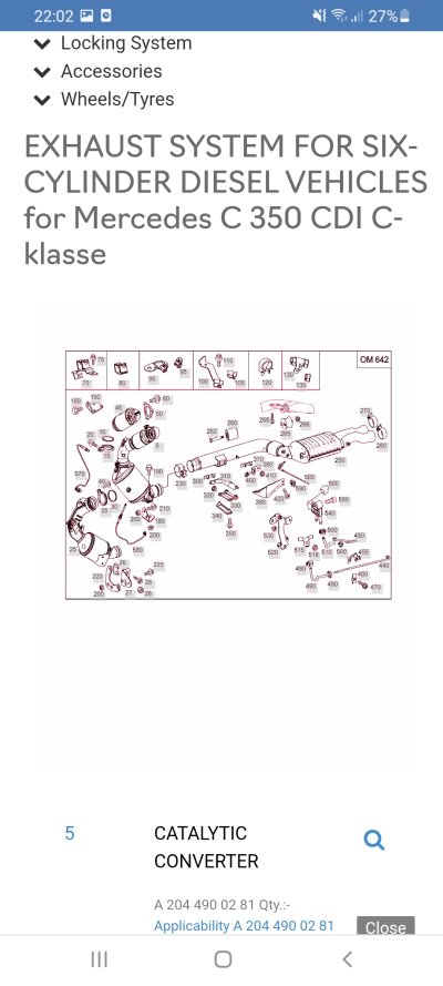

Cheers, not sure, must be reading it wrong, shows 3 lambda part numbers and a single exhaust only for the 6 cylinder diesel

Only 1 in a diesel.
Yes, but shows 3 part numbers for the same one and the wrong exhaust entirely ?
Are they just updated part numbers ?

The diagrams / part numbers on 7zap are wrong
Is this yours ?
That looks more like it, I have part number ending 718 or 918 ?
I haven't looked to see where it is accessed from, under the car or at the back of the engine ?
That's option M014 extra engine power output . It's basically a sports exhaust system.
The sensor on my CLS om642 was in the exhaust pipe area behind the front wheels . It's probably 580 in that picture.
Does it show a part number? not that it makes any odds if i'm wrong as I aleady orderd it :(:)
