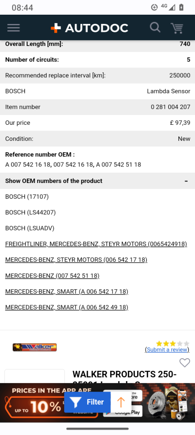

Autodoc lists a sensor for my 2017 e350 as
A 007 542 16 18, 007 542 16 18, A 007 542 51 18
give yours a go. 718 and 918 are definitely on the list. £87 using the ap.

Well done, thanks, A 006 542 49 18 is the part number I was given - just a different length cable.
Parts in motion were £78 inc 1st classs postage for the Bosch one might just pop into the local garage and pay 1/2 labour if they have time, I only have axel stands..

Yep, I did, that incuded the postage on top.
They were very helpful, looked up my part number and added to their system as wasn't on their web page - should be here today I think..
