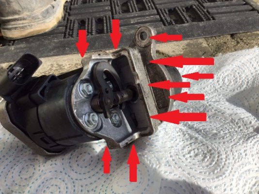

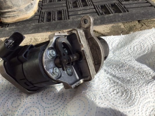

Seen mention recently that the back of the EGR can be removed to check/clean the mechanical inside workings of an egr . Even though I remove mine yearly to spray the gunk off I had never taken it apart before so blaming the sunshine I cracked on with the attempt .
Two bolts to remove the EGR , mine came out easily . I managed to pop the black plastic cover off the valve eventually with only breaking one of the 4 plastic tabs .
The working were fairly clean already but operating them with a finger allows the plunger to be moved a few mm’s to give it a good clean and spray through with carb cleaner .
Word of warning don’t overtighten the two bolts into the soft aluminium threads , I think one of mine is starting to strip but it seems to be holding well enough now .
Maybe there will eventually be another thread of how do I sort this out, but that’s for another day .
I noticed it was still a bit dirty in places so I have put some arrows on to help you locate these areas!!! LOL.jpg
