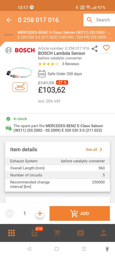

This code reappeared yesterday along with limited performance mode whilst driving, this went back to normal after restarting the engine and has not returned as yet.
I no longer have access to the EPC as it will not run on my Chromebook, would anyone with access to EPC kindly be able to look up the part number for this sensor and it's location?

And I believe there is only one sensor on mine. The location being on exhaust roughly under the drivers seat.
Yep just one sensor , be careful with the sensor , there is another Bosch one that has a slightly shorter cable that won’t fit (but same or similar part number )

Might be this one
When I check on the site it says that the part doesn't fit but thank you for looking and posting 👍

I just checked an old thread I did on the “other side” , the one posted above by Boxer ending in 016 is what came off my car .(the short cable one I mentioned ends in 14, with a 350mm cable , which doesn’t fit)
Thanks. I need to get the MB part number to be sure.

A0035427018
This was the thread on mine
