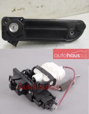

That lock comes in two parts, the upper part where the key goes in and the lower part which is the latching part, it's much more likely that the replaced the lower part, did they actually say that they replaced the lock barrel, if the did then it wouldn't have been seized up.
Dec
It was working after a liberal application of WD40 and use of a pair of pliers on the key blade as it was still rather stiff, according to the invoice from Star Motors for the service just before I got the car the boot lock barrel was replaced by them but it was absolutely stiff as hell which makes me wonder if it actually was.
Squirt some silicon grease into the lock to keep it free.
Just checked and says free off lock barrel and replace lock mechanism. Whichever part it was it was still exceedingly stiff.
