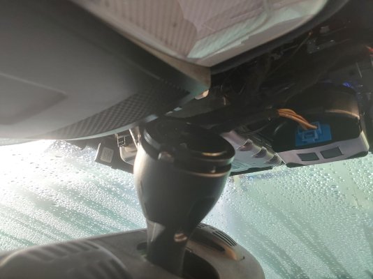

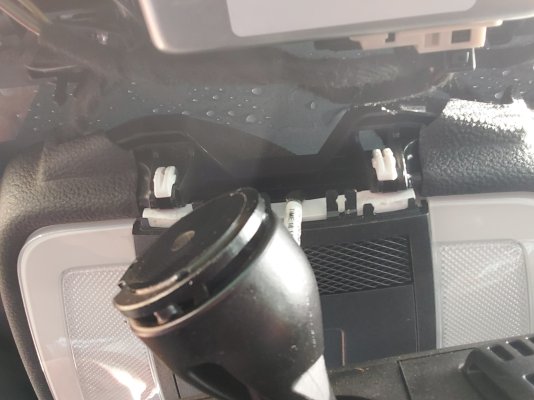

Hi folks. Whilst adjusting the mirror and seat after my hubby had used the car, there was a loud dull thud from the mirror and it fell down as far as the plastic housing. He's had a look on the internet and found a couple of diagrams but it looks different apparently. He's taken off the front plastic trim and the mirror fell to the length of the wires. There is no broken plastic or bits left over, no glue residue if its bonded to the screen. Any help would be appreciated.

I thought I'd put an update to this. After multiple attempts with VHB adhesives and tapes it still let's go after a few days. Spoke with the local windscreen people and they said new windscreen as they come with the arm fitted at manufacturer. I felt compelled to ring, so our local Mercedes dealer also confirmed its a new windscreen. It seems such an over kill to get the mirror reattached. Now considering my options........
We got this sorted yesterday. A new windscreen was fitted which comes with the attachment disc bonded to the windscreen by the manufacturer. The arm then twists onto that disc. It comes with a lifetime guarantee so at least I can now adjust the mirror.
