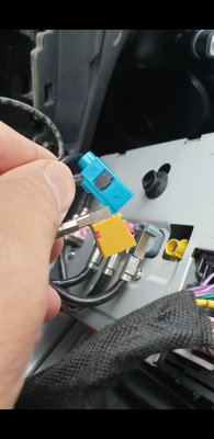

So in the end, I chickened out of buying an Android head unit due to various feedback reviews (mainly poor to be honest). But I did buy a Carplay/Android Auto wireless module https://www.aliexpress.com/item/4000765817904.html?spm=a2g0s.9042311.0.0.5bbf4c4dX7a3Ru which I'm about to fit, along with a reverse camera which plus into the new unit.
I've just removed original head unit, and I've found a spare/removed lead. I think it's an LVDS cable. It looks like the original yellow (which I found hanging loose) one has been removed, and a green one plugged in - in it's place.
At the other end of green one which was plugged in is this
It looks like it goes towards the Becker SatNav unit, but not 100%.
Anybody have any idea why that should have happened, and what difference it's made?
Thanks in advance, again.
