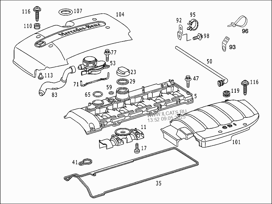

So is it leaking from the union on pipe number 50 in the above pts dia? That looks like two O rings need replaced?
Or pt number 35 rocker gasket,should be another easy fix?
Or is this burried under the bulkhead/firewall,IE nightmare?
I wouldn't return a job back to a customer with oil leaks if I was working on that part of the engine,
Could be several things- since there are no O rings specified in the parts diagram I would doubt there are any? More likely to be just a push fit plastic serrated "tail" connector. Problem with these is they can go brittle and break off inside the cover . The camshaft cover gasket could be leaking if torqued down incorrectly or not renewed. A visual process of elimination by cleanup and and talc as suggested may help track it down.
