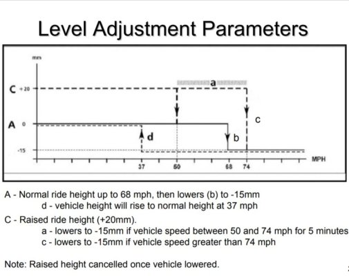

Just wanted to remind everyone that the suspension on the w211s211 E55/E63/CLS55/CLS63 is some what special. It has a feature where the car goes into a special dymanic mode above speeds of 68mpg, whereby the suspension lowers by approx 15mm whilst travelling high-speed on the motorway. The suspension would only return back to its preset ride height when the speed drops back down to approx 37mph. I have never seen such set up with any other car manufacturers. It truely is MB old skool engineering at its best 🙂
