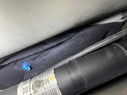

Right.
I have checked the propshaft/handbrake cable situation. Behind the transmission sump I can see three blue clips, all holding the handbrake cable in place securely, so that looks fine.
I have replaced pads and discs, noise still there.
Upon inspection, there is a tiny bit of play 12 and 6 when rocking the wheel, but not in any other directions ( I think it is the other control arm that I have not replaced yet causing this )
Not sure if it could be bearing related? It stops " scratching " when applying the brake. And does not sound like a growling noise that a bad bearing usually would.
Any suggestions welcome, thanks.
