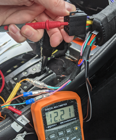

This is a SL350 R230 facelift model with the Comand NTG2.5 (it has the SD reader slot), which I'm attempting to replace with an Alpine unit.
I bought ISO adapters and steering wheel interface recommended by dynamicsounds - Connects2 CTKMB08 - Mercedes SL R230 2004 - 2014 Double Din Car Stereo Fitting Kit
And this is me testing the harness.
The issue appears that the ground and 12v are switched in the connect block. In the attached pics I'm showing a reading from three of the pins on the ISO adapter.
Yellow - shows 12v, which looks correct as this should be the permanent 12v
Black - shows 12v (:confused:) which should be ground
Red - shows practically zero (4.7mv) which should be 12v when ignition is on (I think).
I've contacted dynamicsounds with this info for support, but wondered if I'd done something obviously wrong that you guys might be able to see.
Also, I discovered this _after_ connecting everything together and discovering that the head unit wasn't working. Imagine my alarm at finding that the metal casing of the head unit was 12v :-/
This kit is plug and play, so really don't know why it would do this unless there is a fault in the manufacturing.
Ed

Crap
On the left is the pinout diagram for R230 NTG2.5 on the right is the pinout diagram for SLK r171 Audio 20 system. They have the same connector block, but use different pins.
Specifically pins 15(gnd) & 16(+12) are power in the SLK and pins 12(gnd) & 15(12v) are power for RTG2.5
Despite purchasing the system for a Mercedes SL, I seem to have the connector for an SLK. I used to have an SLK and used the same connector system there, so I actually have a spare harness and connector.
I've used that to "fix" the connector pins, and now get GND and 12v constant, but the connects2 box isn't sending ACC12v (ignition key). This could be more faulty pins, or I could've blown the connects2 box; I really hope it didn't blow the head unit.

Sorted it, will post pictures and update later once finished the install.
I had to cannibalise the old SLK quad connector to get 2 extra pins (from the main wide block), which I used to create pins for CAN BUS High and Low - relocating from the small thin pins. Moved the pins for GND and +12v permanent to correct position.
After a little bit of trial and error - I hadn't appreciated that the speaker pins were all wrong also - relocated the speaker pins, and then tested. Thankfully 🙏 the head unit wasn't fried after giving it 12v on the GND, and it all fired up, and sounds awesome.
TL;DR - rewired/relocated pins based on the NTG2.5 pinout diagram, and it worked.
