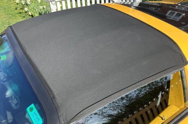

I’ve decided as it’s a nice weekend I’m going to hopefully get the soft top treated and looking like new.
I bought a Renovo kit with fabric cleaner, reviver and ultra proofer.
IMG_6815.jpegIMG_6817.jpegThis is the roof after the cleaning process which isn’t looking too bad. Because it wasn’t in a bad state I used the quick cleaning method using neat product on a damp applicator sponge to apply and then carefully stubbed with a soft brush in circular motions. It was surprising how much filth lifted out of the material and I’m glad I took my time. Im leaving it all day to dry and will start stage 2 in the morning. I’ll take some more pictures as I go.
View attachment 168368View attachment 168369This is the roof after the cleaning process which isn’t looking too bad. Because it wasn’t in a bad state I used the quick cleaning method using neat product on a damp applicator sponge to apply and then carefully stubbed with a soft brush in circular motions. It was surprising how much filth lifted out of the material and I’m glad I took my time. Im leaving it all day to dry and will start stage 2 in the morning. I’ll take some more pictures as I go.

That is great advice. I intend to use recycling bin bags attached with frog tapes that absorbs liquid. The idea of taping on recycling bags is they are clear and I can see any product leaking underneath. I doubt I will be folding the roof over the next week.
The 2 dye coats are now done and just waiting for it to dry so I can do the waterproofing.
This is such a long job to do properly.
Below are the pictures of the first and second coats.
I used to mask stuff up , but now I leave a wet micro fibre cloth handy and a bucket of water just in case , then I just paint or proof carefully . When I’m done I wipe the damp cloth over the glass areas .
