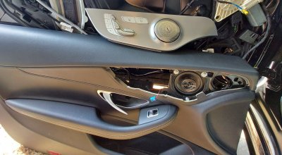

Upgraded the front door speakers today, to Pioneer 4" 2way
Fairly straight forward, removed door card.

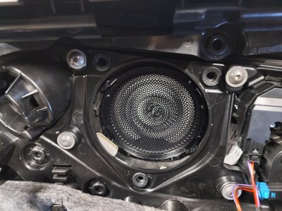

Remove factory speaker and 3 rubber bungs which hold it in place. (2nd pic)

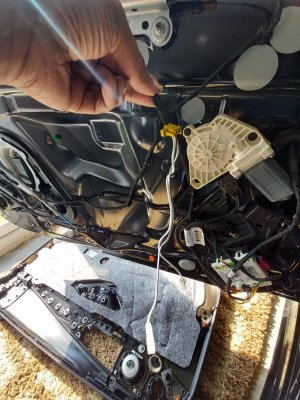

Splice in factory wiring, solder and tape to secure connection.
