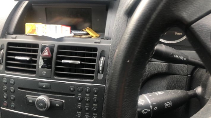

Hi all - My W204 Kompressors been fine since I bought it , but on arriving to pick my daughter up last night she said the engine sounded very loud on idle and when I switched the engine off, there was a noise that lasted 30 seconds. I also thought there was a smell of burning in the air. I opened the bonnet obviously and everything seemed fine though it was dark with only a phone torch.I drove home and put my diagnostic tool in this morning, no codes and nothing showing up on the instrument panel. I have a video of the motor running, all belts and fans are ok -but noisy-but couldn't upload. Any help is appreciated, Regards
