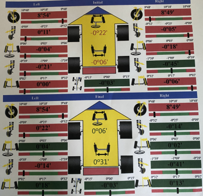

Hi, got my W203 tracking done today by a Merc specialist. Car drives fine - so happy with that.
Seems as though the camber is quite a bit out, I am aware to adjust this it requires different eccentric bolts which allow for the adjustment and is done via the control arms. Is this worth doing?
Just so I can interpret the results. Starting from the top to bottom, is it Camber, Caster , Toe, Caster, Toe?
Also, what do you guys think ? Thanks
The car seems to feel a bit firmer after getting the 4 Wheel track done. Any idea why ? Checked tyre pressure they are all fine
