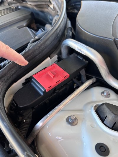

I would like to hook up my E250 up to a battery trickle charger for when it’s not in use (it won’t get driven daily and could sit for a week repeatedly between drives)
I am used to connecting up my old Toyota Celica which was no problem, but that was a more traditional battery set up compared to this C207.
Please bear with me as I’ve only had the car less than a week so I’m learning as I go, plus this is a more complicated car than I’m used to so please be patient.

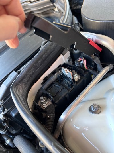

So bonnet up, the main battery is located at the back of the engine bay on the right side as you face it, It has a positive blade just to the left of this which is protected by a red sliding plastic cover.
I presume this is meant for easy access to the battery (positive) to save having to remove that big black battery cover?
Once the positive clamp is on that positive blade I was planning to then clamp the negative one on the metal nuts on top of the suspension strut, does this sound ok?

The open pipe is the ground/negative point for jump starting and/or charging. The fan is the interior blower fan.
That +ve under the sliding cover and the -ve that Alfaitalia has identified for you are the emergency jump start points for your car and are the ones I use for trickle charging my S204 (for the SLK I use the emergency +ve and the nut at the top of the suspension as you thought of ) without problems, much easier on the SLK than pulling the drain etc cover over the battery.
From experience, if you ever have to call out your breakdown folk for a flat battery non start, their heavy duty jump starter may not work on the emergency connectors and its best connected straight to the battery. Been there with the S204 where connecting to the emergency connectors allowed me to open the boot and get at the battery, but would not start the car until connected direct to the battery.
