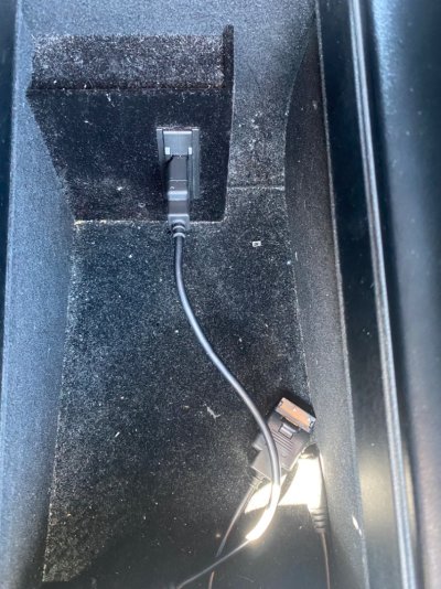

You are correct. The manual does make reference to this, however, I cannot seem to get it to work. I formated a thumb drive as instructed and put some music on it. I connected it to the USB that connects by cable to the interface, but none of the selections on the control panel produce results. I have a USB Bluetooth adapter, which I also tried to connect for wireless streaming, but that’s useless too. Re Satnav, I think I will use my phone, as you say.

What format have you used for the stick? I have used both FAT and FAT 32, as described in the manual, but it does not play anything. The connection for mine is in the centre console compartment, but I think it’s the same type that some have in their glovebox. I do not have an “Audio” option on mine, but I do have an “AUX” setting, which gives me three options. 1 is CD, 2 is the port in the centre console and 3 is unknown. None of them will play music via a usb. As well as a usb socket on a lead, there is an audio cable connecter to the media interface, which I think connects to a regular headphone output jack.
Re your 2010 model, If I do select Bluetooth, the only thing that happens is the phone connects (which it does perfectly) but there is no audio streaming whatsoever or however I try going through the menus.

Its the media interface I use via a cable....which is in the glovebox on mine....nothing in my centre console.....AFAIK! TBH I've no idea which format........I just plugged the USD into my PC and dropped the albums I wanted across into it.
There are various leads available to connect from the media interface in the armrest to 3.5mm aux plug, to USB to play mp3s or bluetooth dongle.
If you PM me your address I'll post you my spare combined USB and bluetooth one so long as you cover the postage. It defaults to bluetooth and you push it's button to switch over to USB. I wont need it any more. Theres some slight signal noise on bluetooth but it's free..
