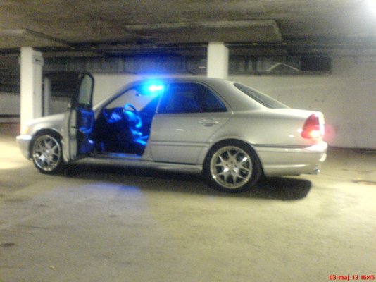

This is mine.
It's still in good shape for it's age.

Yeah it looks great 👌🏼Genuine Brabus rims too?
Thanks.
Yes, rims are genuine Monoblock V, the split versions 8,5 in front and 9,5 in the rear.
Rims grew on me over the years, they look fabulous on the car!
Yeah they look great. Unfortunately they're no good in the UK, the diamond cut finish would last about a week with all our rain and salty roads 😂🤦🏼‍♂️
