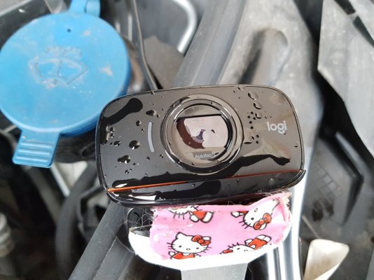

Some pics:
Camera peering into towel-wrapped reservoir:

With hindsight, a splash cover for the camera would have been a good idea:

Some pics:
Laptop on passenger seat:
After lock-to-lock on step (4), bubbles would appear after steering wheel was left in dead-centre:

Great write up. Once you get air in there is no easy way to remove it. You have to be patient and keep doing what you did. Well done. Meant to say I think it was the Hello Kitty plaster which made the difference. 😂
