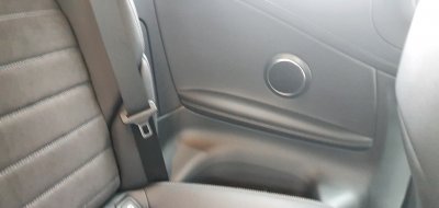

Oh sorry I didn't know there were different systems in this car. All I know is its not the burmester system, has 4 speakers in the front doors (2 tweeters and 2 larger ones) and 2 in the back side panels and 1 in the front dash behind the screen. I dont know if there is a subwoofer installed anywhere.
It has the larger screen. I have the Amg line premium edition.
I've uploaded some photos of the speakers that I know of! :D
I have the Burmeister and I was under the impression that P+ all came with that! I also have two large speakers behind the Rear Headrests, I can see you point regarding lack of Oomph from the back!
I can adjust mine, so more rear level than front and although I don't think its the best System in the World I could make myself deaf if I pumped it up enough, have you tried any adjustments? 🤔
Mine is just the premium not premium plus. I've tinkered around with the settings and it doesn't make much difference. Yeah i don't have the rear speakers in the parcel shelf area so its definitely not the burmester system.

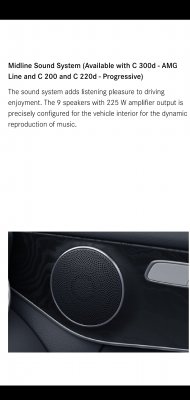

Done a bit of research and it looks like my system is the midline one, so it has 9 speakers! 1 centre, 2 midrange front door + 2 tweeters. 2 in the rear panels and 2 sub woofers in the footwells.
Like i said, it is very front heavy. Unless you put the fader to the rear it is impossible to hear sound from behind you only from in front.
