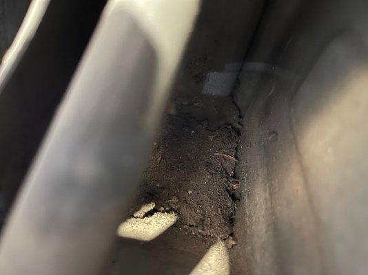

Checked Sunrood Drains
Checked cowl hose goes into NS wing area
Check for water pooling up under the aux battery
Cleared any gunk out of those areas
The Drain Tube was already removed from below the Aux Battery

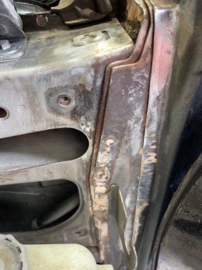

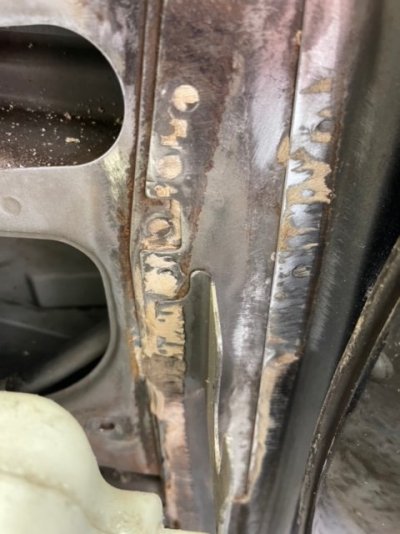

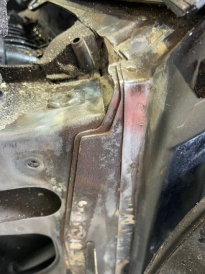

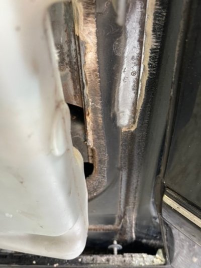

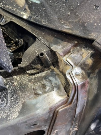

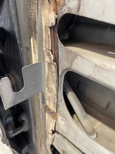

So finally took it to a body shop and we done a pressure wash test. Which showed water coming in, when the pointed the pressure washer at the bottom left corner below the windscreen area, lo and behold, the video shows this:
Once the wing was removed, you can see rust around the seam sealer. the Sealer itself was cracked. Fella at the body shop said it shouldn't be brittle or hard but have some feeling like rubber coating.

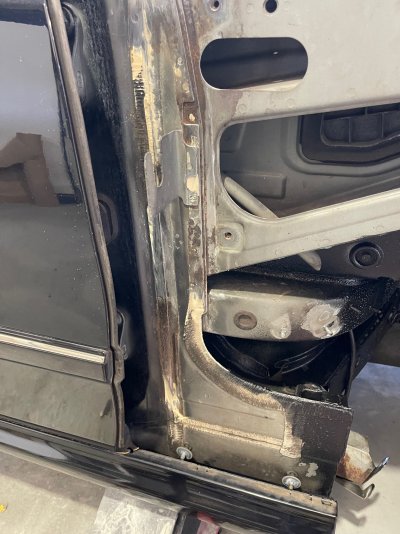

So We chiseled most of it off and removed rust with a wire brush.
IMG_6474.jpgIMG_6475.jpgIMG_6476.jpgIMG_6477.jpgIMG_6478.jpgIMG_6479.jpgIMG_6480.jpgIMG_6481.jpg

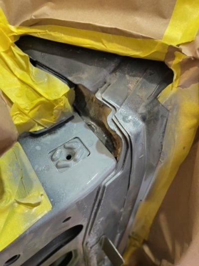

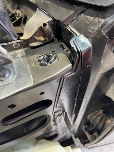

Followed by Zinc Primer and Matching paint.
  • 63.20_15-6.pdf
    63.20_15-6.pdf

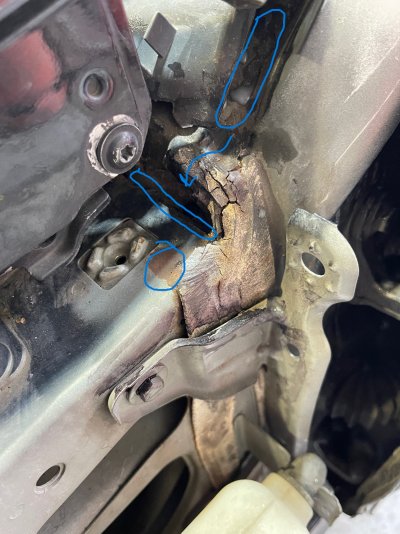

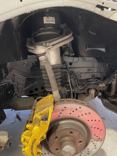

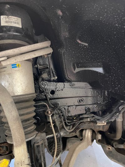

The Seam Sealer, was done in 2 stages.
1st we applied Starchem PU Black Sealer and using a caulking gun, then a brush to push it into any gaps and to spread it evenly.
Once that dried overnight, We applied another layer using a grey seam sealer with a brush also, slight overlapping the 1st sealer.
I couldn't get a picture of it but the hole behind the washer tank, we also applied the sealer there too on the edge (in blue)
Once cured, all was put back together and the last few nights of heavy rainfall show no sigs of water in the footwell now, nor is the windscreen steaming up on the inside.

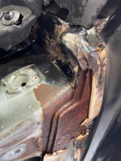

Now I got to tackle the Driver Side too as the sealer here is peeling away and shows rust.
Updating. Done same to driver side now. It wasn’t as bad as passenger side but was still failing in areas where it completely lifted from the chassis.
Very well found and repaired. These 211's are getting rusty now....
