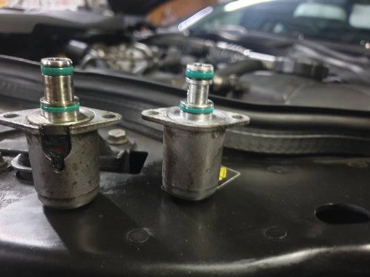

That's the difference between the two, it's a 300 pound part that's dealer only. I picked this up from a breakers. Right is A2214600184. You can see the shaft is skinnier but everything else lines up. I'm gonna go ahead and try it anyway as my car is holding up the ramp. I will report back on any issues or change in sensation.
I wouldn't bother with a breakers for a part like this, too much hassle.
It's a Thomas Magnete solenoid.
Plenty advertised for sale from various sources.
