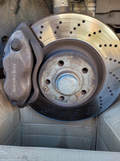

Hi all,
I've watched a load of videos on how to replace front pads and discs but all the front brake callipers look totally different to my car.
The car is a 2013 S212 E350 bluetec ( face lift ).
Could someone please send me a link to a good youtube video on how to replace the brakes with this style of calliper?
Thanks!
I would suggest that if yuu are unsure as to the correct method then it would be better to let a local garage fit them.
Do you have a torque wrench for correctly tightening the bolts and wheels?
Yes I have a torque wrench and have worked on brakes that look similar on motorbikes.
But I always try and watch videos of people doing work before I attempt it as you can often get some very useful tips.
In this case I also need the bolt torq values.

I have changed pads 3 times and discs twice with that setup on my W212. The pads are very easy - you need to push the calipers pistons back by using leverage on the inner sides of the pads. Once the pistons are back knock out the slide pins using a suitable punch tool. These can be stuck and will take some hammering. Clean the pins before reusing. The pads just pull out. Give everything a good scrub and clean and insert new pads, replace pins. Job done. You may want to use a bit of brake lube on the pins where the pads come into contact.
For disc replacement the hardest part will be cracking the caliper carrier bolts - you will need a long bar for leverage. One the caliper is removed the disc should come off with a few taps once the retaining screw is removed. Clean up everything and refit new discs. I never torqued the carrier bolts up just did everything tight but used thread lock on the end of the bolts. The wheels were torqued - iirc @ 130nm

Just to bring another point about the pins on these. Yes, they can be tight. Sometimes very tight. You might find they are so tight that the pin buckles in the middle and you panic. Don’t panic. Use a Dremel or similar tool to cut away the middle of the pin and you can then use a bigger punch directly on the stuck inner bits and they’ll come straight out. New pins can be bought from Mercedes or most decent motor factors. Put some anti-seize on the spring olive before you fit them and next time will be a breeze
