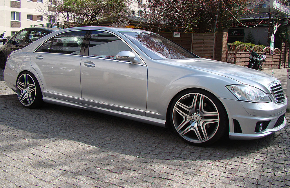

What do you guys think of this wheels?
They're 20" from s class w222 model

I was set on buying the AMG 20" from w222 like the one in the pic I posted and I've agreed on a price for a genuine set but today I went to Mercedes dealership to get some parts and in the car park I saw an s class w222 with the AMG 20" and they just didn't look special enough or big enough. Next to the new s class was a brabus w221, same model as mine and the AMG bumpers but with some carbon parts being the brabus model.
The car had 21" wheels fitted and they just looked right, not too big.
I have to say the car looked amazing, so much presence!
Now I'm a bit worried if I buy the 20" and I won't be happy with them.
I'm going to try the brabus 20" from my van and see what it looks like with 20s and go from there.

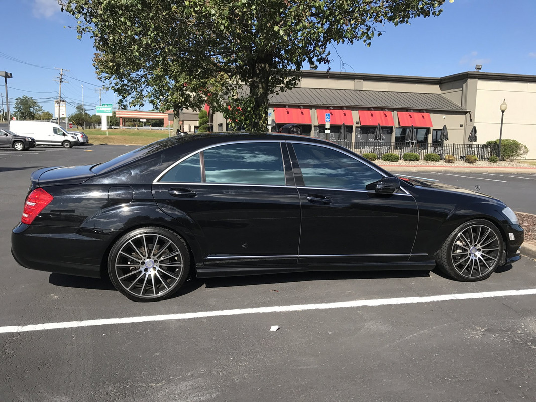

This are the wheels I'm talking about
I doubt you'd need any spacers, If I did I do would use hubcentric. You don't want the wheels to tight to the arches as if your airmatic sank it may damage your bodywork.

I think I'll go for this wheels then. Do you think they'll fit like the one in the pic I posted?
I'm a bit concerned about the quality of the wheels as they're replica and from outside UK
If the offset is as stated they should look no different other than the other car picture maybe running some wheel spacers if you have a spare set of hubcentric spacers on another car whip them off and see if you can get that look ... have you checked any reviews on who your buying from?

Sam, the lower the offset the further out the wheel will sit. So if your original offset is ET43 and the wheels in your link are ET46 they will fit with spacers of a minimum of 3mm. ET46 with a 3mm spacer will bring the ET down to ET43 which is your OEM ET? I would imagine you would need minimum 10mm spacers (which would lower the offset on the wheels in the link to ET36) but only push your wheels out by 7mm as theres a 3mm difference from the OEM offset as stated earlier.
An idea would be to know what ET your are currently running and then with the kit fitted, measure the distance from the wheel to where you want the wheels to sit 'flush' and minus that measurement from the original set up, and you could use that as a guide.
Hope that makes some sort of sense to you.
