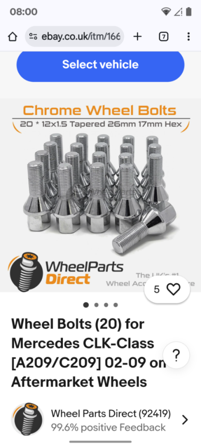

eBay states 26 to 28 mm thread length and a 40 mm overall bolt length.
Thanks but that's for standard wheels.Whatever standard wheels are.
I placed the disc on the back of the wheel and put a 40mm thread bolt through and it only protrudes by 8mm. If I used 26 - 28mm thread bolts it wouldn't go through the disc. Which means it won't screw into the hub.As it will be far to short.
26-28mm bolts will fit the space saver wheel but not the alloy.

Possibly it's the seat taper that's stopping them ?
Bolts for aftermarket alloys pictured.
After doing a lot of research I came to the conclusion that most if not all mercedes wheels use radius seat bolts. If fitting aftermarket wheels then tapered might be required. However, my wheels are genuine Mercedes wheels that came with the car. It's a Clk200 kompressor sport. It has the AMG sports package. I have a standard space saver spare wheel which came with shorter bolts. As the longer bolts will make contact if used.
