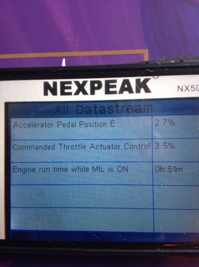

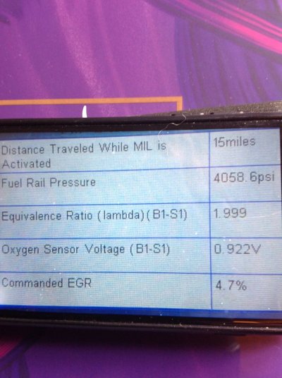

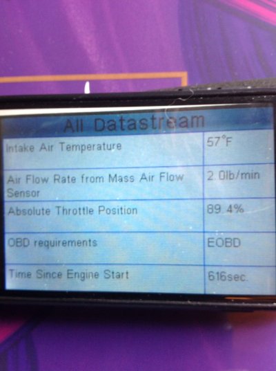

I've done live scans on my basic obd reader & this is what's happening on idle!..(just trying to down load them 🙈)
Apologies for picture quality...Can anybody draw a conclusion from these?

O2 sensor is reading 0.922 V so it's working. Not sure what the V should be on yours but recently on my Petrol Toyota Yaris S1B1 was 0.780V and S2B2 (after the cat) was 0.700V with the cat at 622'C intake and 620'C outlet if that helps.
Why is your scan tool on non metric settings ? something you prefer ? just curious.
Thanks for reply Petrol Pete...I think the volt reading should be max .9v I've just been out & done a live reading,it varies anything from
0-1.3v fluctuating!...Would an hours diagnostic at Mercedes tell anything more procise in you opinion?
With ref to my scanner being set on 'non metric',only used it a couple of times & havent changed the values over!..
