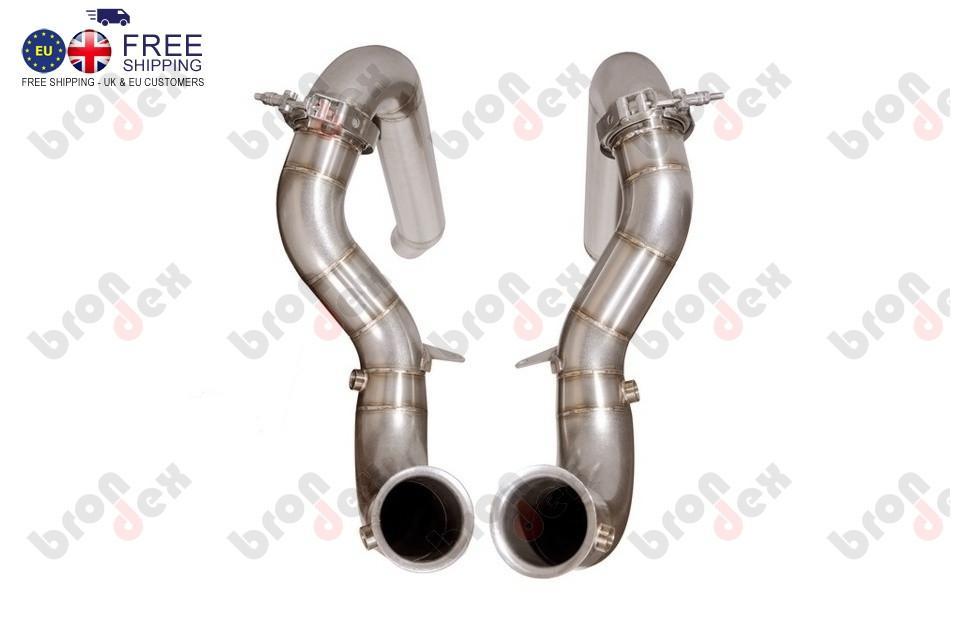

Not really looked at after market stuff re the cats/downpipes - does anyone have any experience or can point me in the right direction. With a potential 6 month wait for OEM parts there must be something that’s easier to get hold of….I know I ranted yesterday re getting rid of the car but I do really love it and want to find a solution (I’ll take the dealer to court over it anyway) and came across this for 1/3 the price Merc want to charge….no experience with this stuff at all but guessing gaskets/seals required too?
If you go the non-OE route I'd have thought any decent exhaust shop should be able to sort you out. Hardly the same thing but I had 200 cell sports cats fitted to my SL500 by a local Longlife franchise. The car was subsequently MOT'd by a main dealer every year without any adverse comment at all (in fact one of the staff remarked on how good it sounded :) ).
No personal experience of them but places like MSL (already mentioned in this thread) seem to have a pretty good reputation here ... not too far from you either:
Another option maybe to find a Powerflow or Longlife dealership near you to see if they can custom fabricate what you need
Edit beaten to the gun by BTB 500 !
Most aftermarket sports cats are 200 cell versus the more typical 400 cell OEM. They also tend to be metallic rather than ceramic. This means they flow better and are more resistant to higher temperatures.
You would need to declare the exhaust downpipes as a modification for insurance. Strictly speaking it's illegal but in practice you'll probably pass an MOT as they can be hidden by the undertrays and it has low enough emissions. Best to leave the rest of the exhaust standard because a sports cat also makes it louder.

If you feel like taking a brave pill then you could go for catless headers.
Look up @supercar_olly on Instagram, he’s just fitted some @br_motorsport on his GT (not a GT R) and he’s besotted with them.
Would love to but I don’t (at this stage) have the stock cats to put back on for MOT…. decat would be a fail
With replaced catless down pipes refitting the cats isn’t an option. It seems cars do pass without the cars. The MOT tester could fail a car if they believe the cats have been removed but it seems that cars still pass.
It’s a head and heart scenario. Head says, stock, court, fight it go back to what I had. Heart says, downpipe, sport cat, stage 2 +700hp and bloody enjoy the thing!
You have a beautiful car, if it were mine, I would have completed a sports CAT 200 cell mod by now and during winter time when the temperatures are colder, take it down to msl for a stage2 map and get them to do a once over check.
I don't think i would risk putting a new stock system at the moment, without having a check and risk it getting melted again. Can always purchase oem stock system anytime later in the future, it's totally reversible mod.
