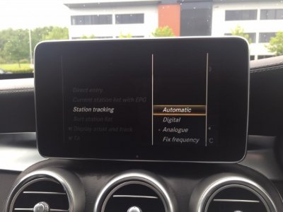

OK, sorted!
There is a 'station tracking' option within the 'option' menu of the radio on the bottom RHS of the Comand screen. With the options
  • Automatic
  • Digital
  • Analogue and
  • Fix frequency
In order to keep on FM, One needs to select 'Analogue', then save the station as a favorite. That remembers the 'analogue' (i.e FM) only setting.
'Automatic' is the default setting and unless you save the station with 'Analogue' selected, when you change stations, then return to it, it reverts to automatic Digital (DAB) / Analogue (FM)tuning
Once saved with 'Analogue' (FM) tuning selected, the word "analogue" is displayed below the radio Frequency
sorted... :) no more radio skipping between DAB and FM! :)
