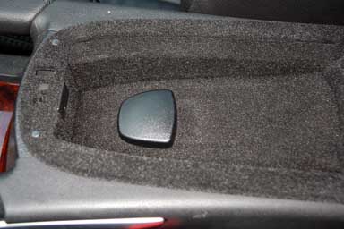

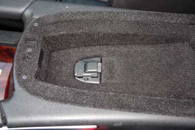

If you have UHI then you have a connector like this
http://www.mercupgrades.com/pictures/phones/ML_HFP_connector_384.jpg
Somewhere, either on the side of the dash on a phone console thing, or in the centre armrest
The connector may have a cover on it, and it will look like this
http://www.mercupgrades.com/pictures/phones/ML_HFP_cover_384.jpg
Alternatively you have a cradle already there, various types, can be seen in my ML UHI phones document at above site.
Richard
