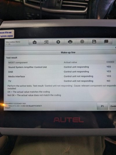

please see the attached pic for further detail. My Command Unit is no longer working. I have checked and charged the Aux battery but to no change.
Running my Autel Diag reports an issue with the HU and MOST. Further tests using the live Wake-up line shows the Media Interface as not responding ?
Any tips on where to go from here ?
Chris
Its coded to NO so I would assume the car is not equipped with the tv tuner. In which case, its querying a module that does not exist.
I would think that you are in the Comand module to be able to run that test, so you have comms with the Comand unit itself.
What is the issue?
That is correct, there is no TV so I am not concerned about that. Its the Media Interface that is not reached. The Command screen is completely blank, there is no power to the keypads but I can hear the CD player whirring.
I have checked all the fuses, recharged the Aux battery but still nothing.

Full Autel diag
HU(Head Unit Control Unit) ( 4 DTCs )DTC Description Status
D016 MOST communication has a malfunction (position of ringbreak cannot be identified). Active and stored
D017 MOST communication has a malfunction (MOST masterreporting ring break). Active and stored
C255 Communication with the central display has amalfunction.Active and stored(Eventcodes)
D185 Communication with the control panel 'Head unit' has amalfunction.Active and stored(Eventcodes)

Just completed another Autel live test and now have the following errors with regards to the Command Screen. I have manually restarted the MOST ring but no change.
My experience with a MOST ring break is that the head unit gets stuck in a boot loop, only showing the MB logo and then powering off.
Not sure how the head unit module can report no comms with the head unit module......
I'd be thinking a faulty head unit at this point, but you could loop the most ring at the head unit and see if it boot loops.
