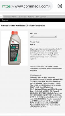

image.png image.png Been looking again, as you do and both the g40 and 48 says, has a service life of 5yr
Yes, I did see that. Talk about misleading.
