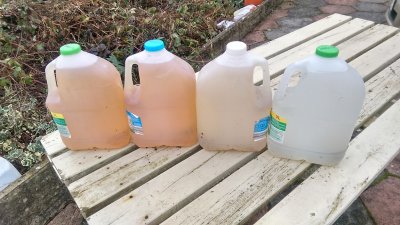

As proof of the colour, I have attached a pic. The Comma G48 I bought, is in concentrate form, but I wonder if the mixed version has a different colour? Just a thought, as there seems to be a bit of conflict about the colour of the Comma Anti Freeze. I also posted a pic of the drained and flushed Anti Freeze. I have no way of knowing if it is the original Mercedes 15 year antifreeze or not. Maybe some one more knowledgeable than me can throw some light on it, based on its colour? Not that it really matters now as I refilled with Comma Xstream G48, so for future reference I know what to top it up with.

Going by the age of your car 2011 and the Orange colour of the coolant ---referring to the chart your previous coolant would have been the HOAT -G05 based type -----
Thanks for the info Graeme, yes, I'm sure that you are right, it most likely is the original antifreeze, from when the car was new. And any work carried out by the MB dealership earlier on ( timing chain and sprockets replacement ) they would have used the same antifreeze at that time. My problem was that due to a small ( very small) coolant loss, I was topping it up with ordinary water, so the mix was becoming diluted....and I did not want to add antifreeze, and risk adding the wrong kind, then having a bigger problem. I went to my local MB dealership, and they recommended MB A 000 989 08 25 10, but they could not tell me if it was mixable with the existing antifreeze....so I flushed the system out completely, and refilled with the G48. So now my only question is if the MB A 000 989 08 25 10 I purchased is compatible with the G48 I have put in the car? Your advice / comment's are welcome, Graeme.
