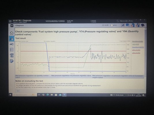

So my wife has a b180 w246 blue efficiency, it was running rough and had a bad smell of diesel, mechanic at her work looked and said it needed injectors they were all leaking.
I ordered 4 refurbished injectors and before i got around to fitting them the car broke down, lost all power, went in limp mode and smoked alot.
Luckily it was close to home so got it back.
So injectors fitted and coded with xentry, car starts and ticks over fine however throws up two. Odes and goes into limp mode upon trying to drive-
P025219
P008891
I have ran a y74 and y94 test and both come back fine, i have ran a high pressure circuit leak test and it failed saying it was “leaky”, i cannot see any leaks anywhere however.
Have attached the test results but I am a little at a loss here.
The car starts and ticks over completly fine but when you rev it over 2500rpm it brings the EML on and enters limp mode with next to no power.
any ideas guys?
