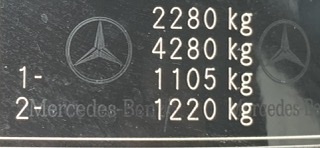

Your VIN plate is all you need. It could be in several locations, but check inside your driver’s door.
This link show a VIN plate and how to read it: Maximum Towing Weight
Appreciate the swift reply. I have on the passenger door a “sticker” plate with this data (have to check exactly the content). Is there another proper (metal) plate anywhere else?
LE any known experience on towing with this engine (350CGI)?
Well...it's a big petrol, so it's got to be good.
That’s the plate (aka sticker)
So I guess it should be homologated

LE: so basically reading the plate I should be able to tow up to 2000 kg. Checked on a website (Outfit Matching Car and Caravan) best combination car model and caravan and in order to get a perfect score it was recommended ding maximum around 1100 kg. Quite a big difference compared to 2000 kg.
That's because they work on the 85% advisory level I would suspect, still does seem low though

Seems very low , against a kerbweight of 2280 Kg ; 2000 kg seems a perfectly reasonable trailer weight , I’d go with the manufacturer rather than a magazine .
