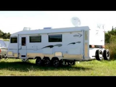

Twin axle caravans typically offer a little more interior space, are more stable than single axle caravans, less likely to snake, less susceptible to side winds, and are easier to reverse. Drawbacks are rhat they’re almost impossible to manouvere “by hand”, you need to be hooked up to the car or have motor movers fitted.
Other potential drawbacks ...
Higher service cost (twice the number of brakes)
Twice the number of tyres to replace
A bit trickier to level (you need to raise 2 wheels rather than 1)
More likely to to be stolen (in the UK, anyway).
