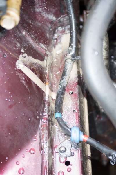

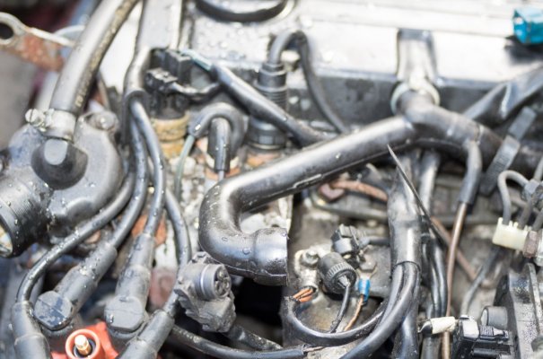

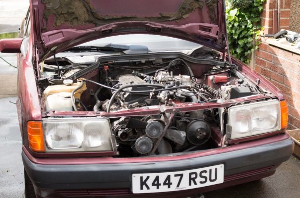

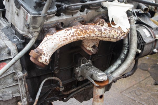

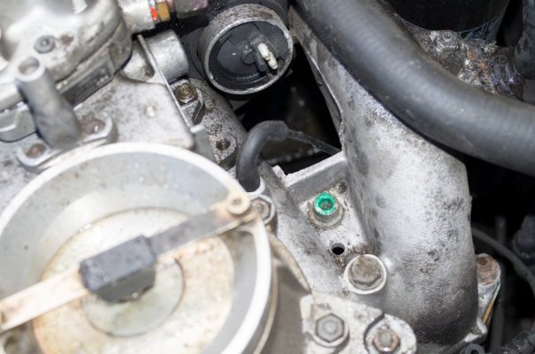

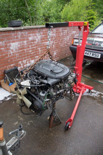

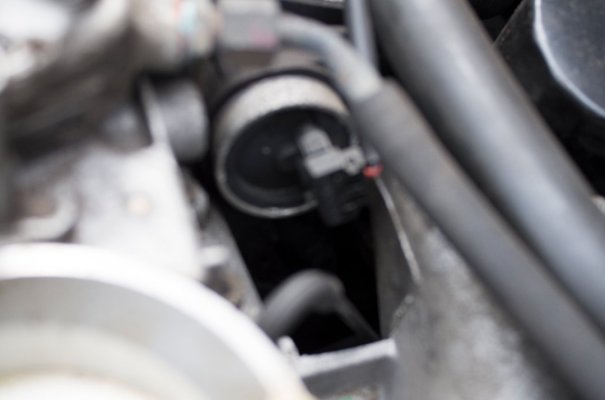

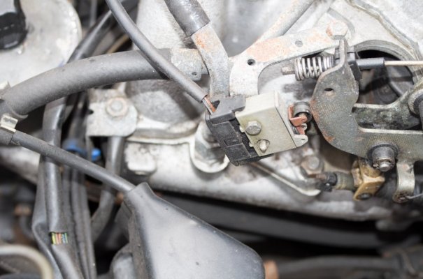

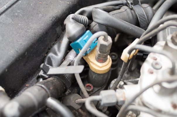

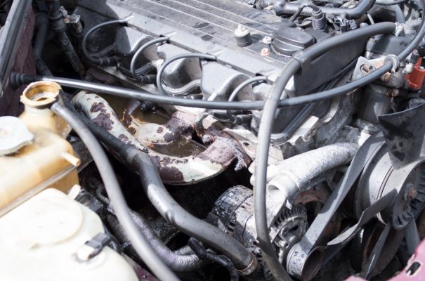

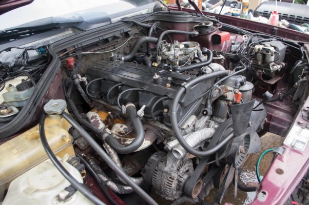

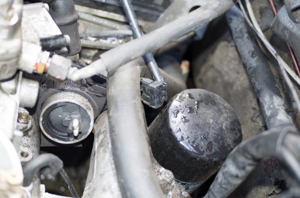

Here are some shots when I did the 1.8 to 2.3 swap into my 190LE - the 1.8 had a head gasket problem - very common and not worth fixing as the 1.8 heads are of lesser quality than the other ones and it will happen again .
1  _IMG0577.jpg2  _IMG0578.jpg3  _IMG0579.jpg4  _IMG0580.jpg5  _IMG0581.jpg6  _IMG0582.jpg
