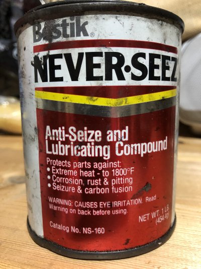

Dont install them using any copper paste.
Use a sachet of Wurth Brake Paste.
Ashlee, do you have any thoughts on the powerstop ceramic pads from the states?
Interesting, is it just ceramic brakes or do you not recommend copper paste at all ?
Copper paste actually voids the Warranty on brake pads.
Copper is a conductor of heat and electricity. You only increase the transfer of heat trough to your calipers and raise the temp of brake fluid.
Never use that stuff. It's awful
I always use Wurth products, they're usually a bit more expensive, but they really are better quality than the other brands of paste.
Also copper paste turns horrible after a few months. Its like the residue you get when you clap your hands together when you handle a moth.
Also wurth paste is really good to use on the thread of spark plugs and the assembly hub.. I actually use to have aluminum air valves and used it on that too. The stuff just performs and performs. Even some Superbike teams have the stuff on hand too.
Brilliant, thanks for your advice

We use a high temp brake grease to fit our pads. Its excellent stuff.
I haven't used copper grease in about 20 years. Horrible stuff and very very old fashioned. Its banned in my workshop.

I cant think of anything I would use Copper Paste for in 2020. I would not use it on even a wheel hub.
