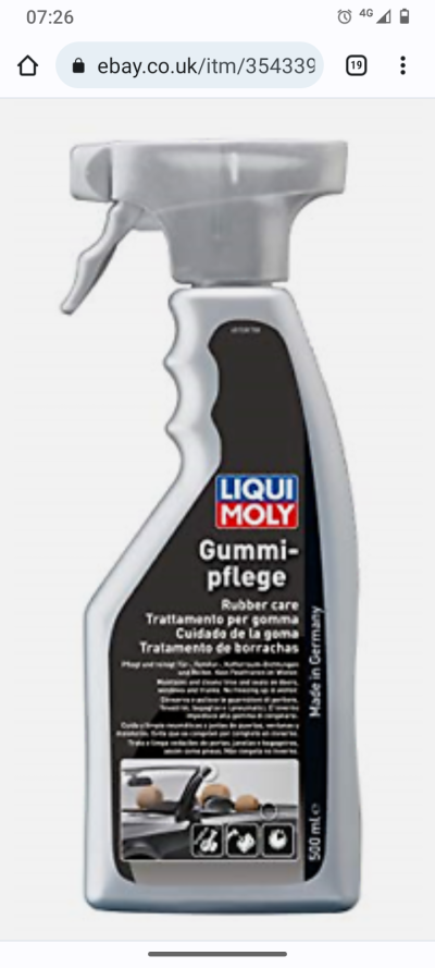

Just to make it clear, Gummi pflege is German for..............Rubber care, it is not a brand or special formulation.
So Liqui Moly Gummi pflege is just Liqui Moly rubber care and Wuerth Gummi pflege is Wuerth rubber care.
Just saying![]()
