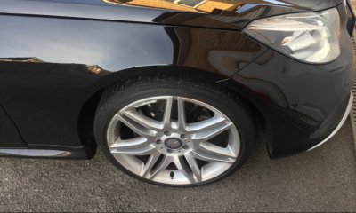

So I got the buckle fixed. It cost me £70. Got the car back and it has been fixed but only 96% the other 4% I notice a tiny bit of vibration only around the 60mph mark. Like no other person would notice but I’ve done 50k plus miles now with the car and I can tell. Maybe it’s due to the tyre as I did travel like 320 miles on it before getting it fixed? Who knows. Or maybe when I hit the pot hole my rear alloy got a little knock.
Will get all four wheels check out at some point then go down the route of getting new alloys or even try a different alloy repair company. Just want the best or nothing [emoji4]

Balancing very possibly the issue here and will (to some degree) cater for uneven wear in a tyre? Getting the balancing right requires a tech that wants to get it right and will make sure it is right. A wobble at 60mph would indicate a very small amount weight is required to be added or subtracted. A good balance will also place the weights across the width of the wheel rim and not just stick em' all round the outer or inner rim? It may be worth visiting a recommended shop in your area, sitting them down, explaining the issue and your expectation.

I’ll get all 4 wheels checked and put on the balancing machine. Fingers crossed this will sort it. If that doesn’t work I would be happy buying a replacement alloy from eBay , ones that haven’t be welded or buckled that I’ve seen. £320- £350 each. Hopefully I would only need the one alloy.

Update: So after thinking the repair wasn’t great, I thought get all the wheels rebalanced and checked just in case. This way I can check if the repair job was good or if any of my other wheels were causing me problems.
Repaired buckled wheel was perfect, I can’t believe how much of a good job the repair guy done. So I was hoping it was one of the other wheels that was causing the problem and not a suspension error. So it turns out that the rear wheel was also buckled at the same time as the first(damn you pot hole!). I’m glad I got them all checked out now. So back to the alloy specialist to get that repaired and my ride should be back to normal.

Buckled my 19” alloy on a pot hole. I knew i damaged the alloy as it instantly had a vibration feeling through the steering wheel.
I got my wheels checked out at my local tyre garage. They put the alloy on a wheel balance machine and you could clearly see the buckle on the inside of the alloy. It only cost me £5 for them to check it.
Took it to my local alloy buckle repair garage, not many places repair them. Cost me £70 for them to repair it, duration normally takes 3 hours depending how bad the damage is.
Drove off and tested it on the motorway, it was much better but it wasn’t perfect. I did read on forums that buckled alloys are never 100% after a repair. So just assumed I needed a replacement alloy to get it 100%. I thought that maybe they didn’t balance it right. I couldn’t live with it not being perfect so got all the alloys rebalanced (might of been a rear wheel problem as I could feel some of the vibration coming from the bottom of my seat) and checked for buckles costing £10. The repaired alloy was perfect, the guy from the garage said it was rotating perfect, so it wasn’t that but one of my rear alloys. So if you ever hit a pot hole I would suggest paying a little be extra and checking all yours wheels why your at the garage.
Took it in for repair and now my car runs smooth again. Not even the slightest bit of vibration.
I do recommend buckle repairs if it’s the inside of your alloy. It will save you hundreds. Outside (alloy front face) buckle is trickier to repair but it can be done.
