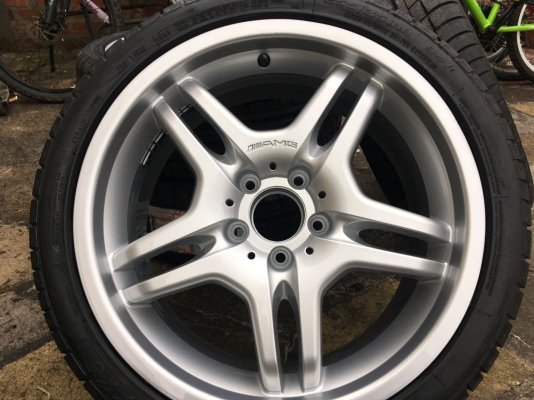

I have looked for the plastic covers but have not found the correct shade of silver/grey to match my wheels . Anyone who has please post a link .
