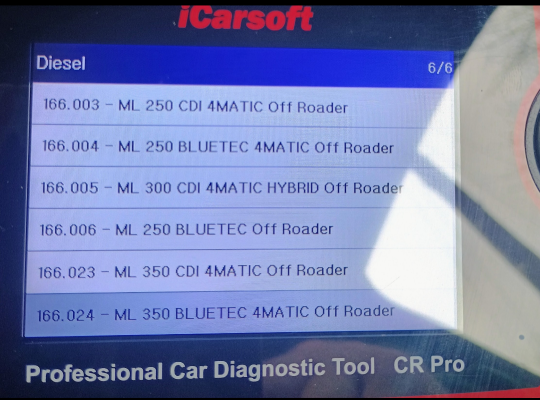

Try other Diesel engine variants. Bizarrely, I discovered that it will read certain types of data if you choose the 'wrong' engine type, but not if you choose the correct one...
My selection for a 2018/2019 glc 350 coupe. An issue that makes icarsoft poor in my opinion.
