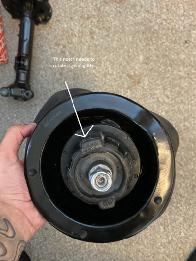

Got my struts assembled by a Mercedes independent which I will be installing myself.
Concern is that the mount needs to go into the car like this... Note how the notch ( White arrow ) up at 12oclock position
The part I just got assembled has the notch at roughly 10oclock position
Is there any way to safely rotate it, or will I need to install it first then rotate something ?

BTW I have fitted the strut no problem :)
Did the top section just rotate ?
Yes, not the rubber part, but the metal looking part on the outside ( which says Febi )
Put the mount up there, tightened it down, then rotated the shock by hand to a more central position and then continued with installation.
Few odd noises from the outer part initially when turning which has now completely stopped as it's bedded in a bit ( some silicone lubricant helped massively )
