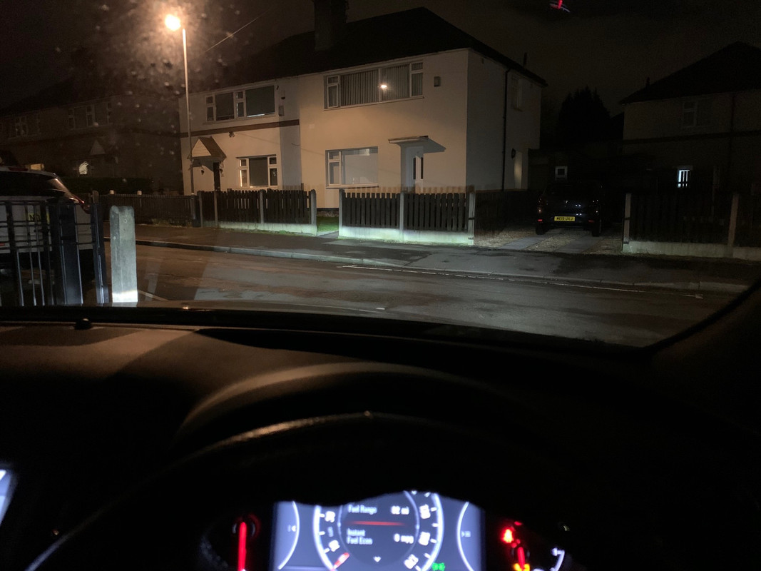

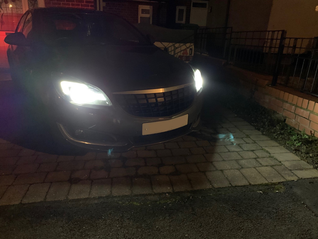

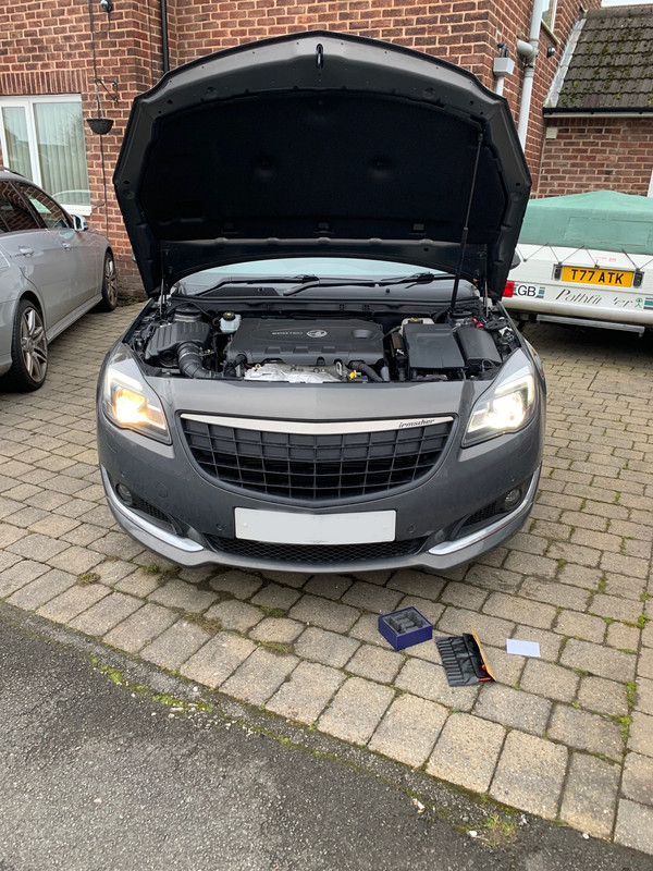

I have fitted LED lamps in my wife's Vauxhall Insignia and they are a massive improvement on standard. They light up the road much better and no flashing from oncoming motorists so I guess they're all good.
This is what I fitted -
50 / 50 shot of old and new -
Night shots -
Night shots -
They look OK, have they been checked on a beam alignment rig as used by MOT station ? Is it a legal requirement to have headlamp wash , or is that just for Xenon's ?
No not been checked on a rig. I guess I'll find out at MOT time. Other people on the Insignia Owners Club are using them and have had no issues at MOT time.
