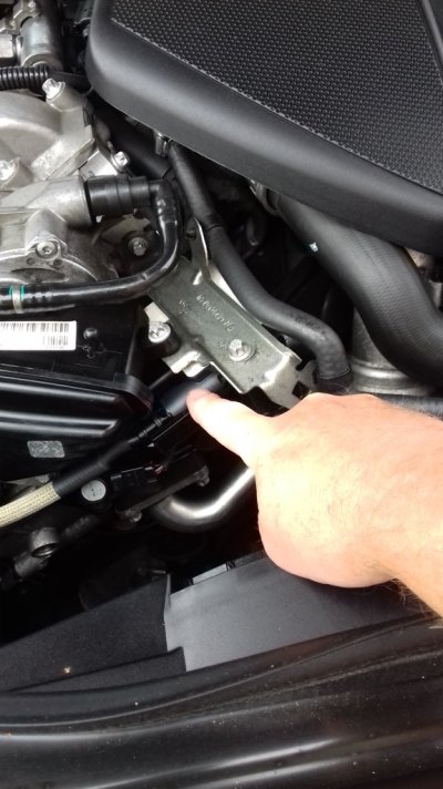

I have a 2007 E320 Cdi 3.0 V6 Estate.
It seems my glow plug control unit has failed.
can anyone tell me where I will find this unit please. I want to check its part number So I can source a replacement.
Thanks very much indeed
Kev
At the front of the engine , slightly to the left .
Recommended changing all 6 plugs first .
Kev
I am sure it is toward the front of the left cylinder bank (with you standing in front of the car) attached to a bracket.
To be sure just trace back from one of the glow plug connections.
