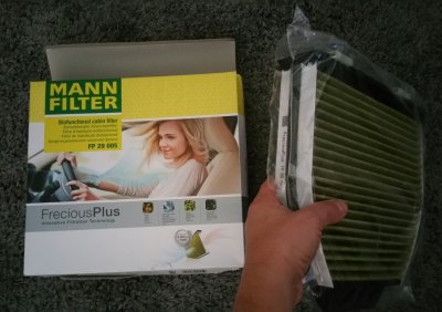

Since these cabin filters often contain activated charcoal you can understand how quality/shelf life is important. The knock offs will look/ fit the same but will be of inferior quality. here's a "how to" for the W204
There can only be one and the best on the market activated charcoal pollen filter...
