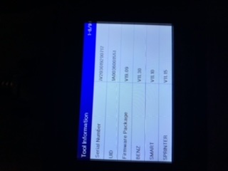

230E80E5-57B1-4A72-B4AF-D93A8A4D7DE5.jpeg Hi guys and gals.
I’m back in the Merc world having picked up a 2014 E220 AMG Sport a couple of weeks back - delighted with her.
problem I’m having is that I bought the iCarsoft MB V2.0 last week direct from iCarsoft in the Netherlands. I wanted it specifically for DPF regens. When I got it, firstly the software on it was V1.3 even though they had a little leaflet with it claiming it was up to date, secondly my E220 wasn’t listed!!!
Updated the software to V11.30 and now the car is listed but no manual regen option. Only an option to regen whilst driving but when I go to set this up I get “Communications Failure. Application Failed” on screen. I’ve emailed them about it and have been completely ignored, not one response.
has anyone here had this issue or know of a workaround? Scanner currently reading DPF fill level at 61%, Soot Content 4g
