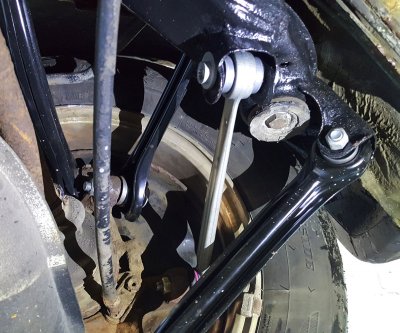

Due to the labour aspect of the job I would be inclined to go LEMFORDER. There are 4 subframe mounts. Its where the 2 front mounts are fixed to the body that are most vulnerable to corrosion. That whole area rear sill jacking point and front rear subframe mount are probably the source of the most frequent MOT structural failure in the whole car.
So, car returned today with refreshed rear suspension.
Lemforder kit plus a further assortment of control arms, ball joints, bolts and seals (MB parts)
Subframe and diff removed, stripped down, descaled and painted. ARB bushes, hub carrier joints, spring swing arms and diff seals replaced.
Can it be my imagination? Car feels tauter, steering sharper and the ride quieter. All in all a great job by the guys at HR Motors, Galashiels!

Confirmed that chassis totally solid with slight surface rust...

View attachment 72373 View attachment 72374 View attachment 72375
£854. Lovely job. I paid ~£180 to an MB Indy to have my front mounts only replaced on the rear subframe of the 204, from memory, but could be wrong as it was 5 years ago.
