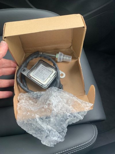

got this for mine but wrong one for my model , very hard to get lots on back order.
