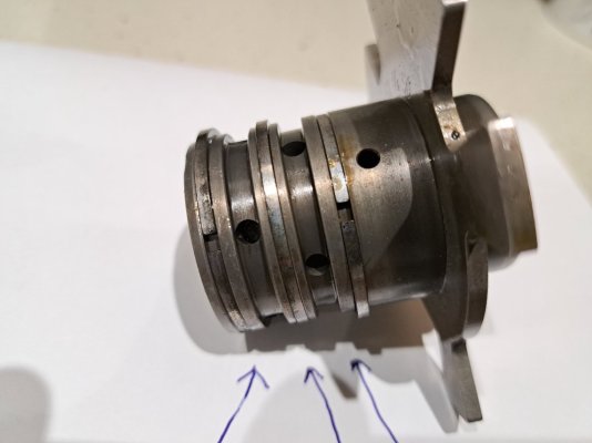

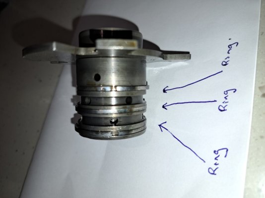

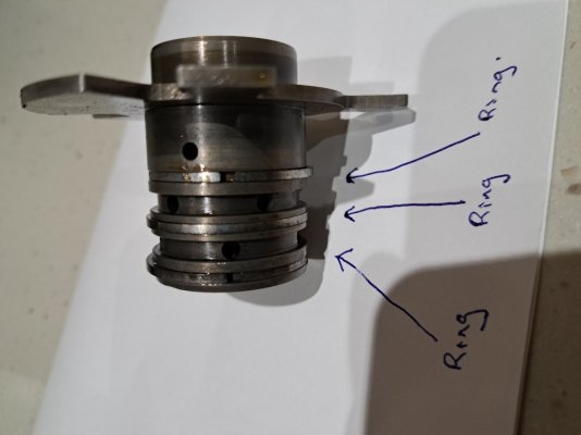

That's your front timing camshaft covers, the seals are about £8 each from MB. They're none sided part, so the left side works with the right side. When you remove, take care the rings on the phasers are seated as you reinstall, the rings sometimes move out of position. You can reuse the existing screws, also place a few towels over the serpentine belt and alternator, about half small cup amount of oil will spill out👍
