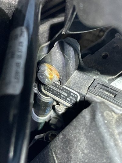

Yeah, I did look. Is that £28 inc delivery?
Well there's your bosch No 0280006025.
I have a local Bosch accredited diesel engine specialist in my town. I just picked it up, so no shipping. A couple of days to come in from Bosch so zero worried about counterfeit.
That Bosch number comes up as this: https://www.amazon.co.uk/Bosch-281-Manifold-Pressure-Sensor/dp/B00YCL5I28
So it's not quite the right number for the current Bosch range, at least. The Bosch replacement appears to be 0281006278, as in my original amazon link
